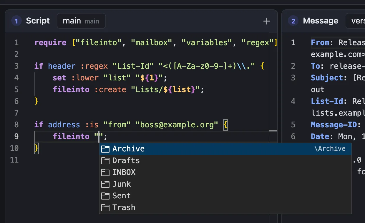

Autocomplete takes the position of the cursor into account. It suggests commands, tests and tagged arguments together with their documentation, offers extension names inside require, mailbox names inside fileinto and built-in functions inside Stalwart expressions, and completes the names of variables the script has set inside a ${...} reference. Hovering over a command or a tagged argument explains what it does and which extension it needs.

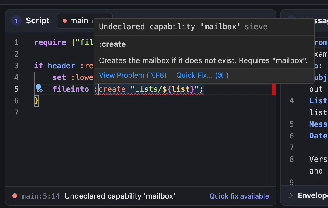

The script is compiled while it is being typed. Errors are underlined at the line and column the compiler reports and listed under the editor, so a mistake shows up before the script ever runs. A frequent Sieve error, using an extension without declaring it in require, comes with a quick fix that adds the missing declaration.

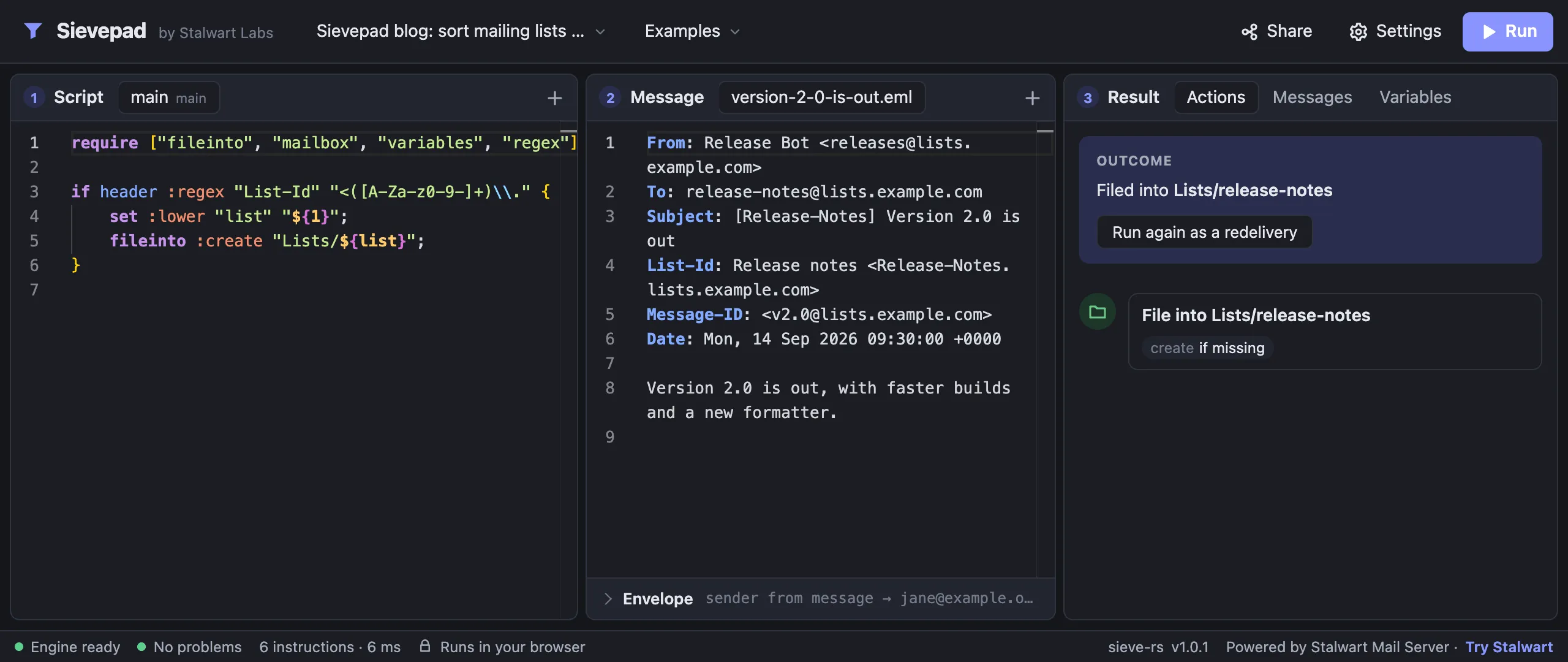

Section titled “Running scripts against test messages”A workspace keeps one or more test messages next to the script, each in its own tab. A message can be pasted in as raw text or dropped onto the page as an .eml file, and the envelope sender and recipients can be set independently of the headers. Pressing Run, or Ctrl+Enter (Cmd+Enter on macOS), executes the script against the selected message.
The Result pane shows what happened. Its Actions tab lists every action in order, with the details that matter: the folder a message was filed into and the flags set on it, the address it was redirected to, the reason given for a rejection, or the vacation reply that would have been sent. The Messages tab shows each message the script produced, from the delivered message after editheader or replace changed it to the vacation replies and notifications it generated. The Variables tab lists global variables and the number of instructions the script executed. When a script fails at run time, the error is marked on the line where it occurred.

The mailing list filter from earlier makes a good first exercise. The link below the script opens it together with the Release-Notes message, and Sievepad runs it straight away: the Actions tab reports that the message is kept in INBOX. Changing the character class to [A-Za-z0-9-] and pressing Ctrl+Enter files the message into Lists/release-notes instead.
